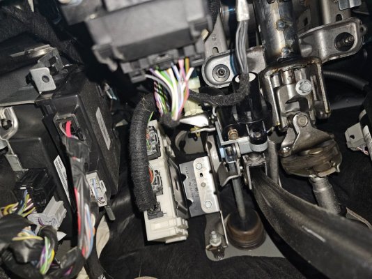

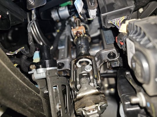

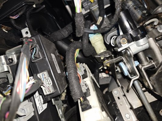

So I have been searching this awesome community of knowledge and need help still :)
I wanted the HD towing but could not pass up this one owner TX expy that was babied - no HD towing pkg
It has the round and flat trailer plug adapters - and in the back storage was an unopened wiring adapter that is
JL1T 14A348 - with a sheet showing what pins are for gnd,pwr,brakes, etc
I checked under the dash and am not sure if I can find a controller module - I can ul some photos later.
Popped off the "coin holder" insert and there is no wiring behind it.
I ordered a generic brake switch off amazon, and ordered
Trailer Brake Control
GL3Z-19H332-H
because truck has lane assist - hopefully I ordered the correct module (please hit me if I didn't!)
So is there going to be an existing plug to connect to the newly purchased module under the dash - and what wiring do I us to connect to the purchased brake switch ??
Thanks in advance for any help!
Love the truck - really miss not having 9000lb towing ability!
Andy

Thanks For the reply and info! I am pretty sold on using the Ford integrated controller - unless the P3 integrates and can be controlled but Truck software.
My big unknown before I take apart the dash when the controller arrives - is what wiring is already there and/or what do I need to rewire - there is a section of wiring harness that was in back of the truck that has a plug on one end and bare wires with labels on the other... does this mean I have to wire this in somehow to get the 7 pin to use the brake controller?
Thanks,
Andy

I bought a Ford trailer brake controller. The plug for it is not behind the coin holder but a little cubby, right of steering wheel and left of the center console.

Round "RV" trailer 7pole connector is part of the HD Tow package so you have that. The Ford OEM brake controller should snap into the "coil" bin on the dash (after removing the pin, of course) and plug in to a matching connector under the dash. (It's got several pins. 4? 6?)
Used to be this way anyway... :)
-- Chuck

This may help some new 2019 owners installing OEM trailer brake controller.
Wiring is there behind little cubby. My platinum had 7 pin already in by hitch
