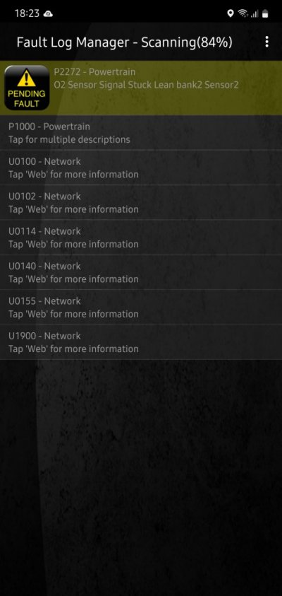

Thanks! Finally got the Beast today.. Funny though, after all the paperworks and money changing hands, off to the city limits to get the feel of such a big vehicle in hiway and traffic jam conditions when the CEL came on. Only had an obd2 BT dongle, but torque pro retrieved these error codes:Screenshot_20230617-182356_Torque.jpg
Guess I really need to get Forscan then. Previous owner mentioned he had the 02 sensors replaced last year. Dunno if that's true.
Cleared the CEL. Still researching what that fault means in terms of repair / replace.

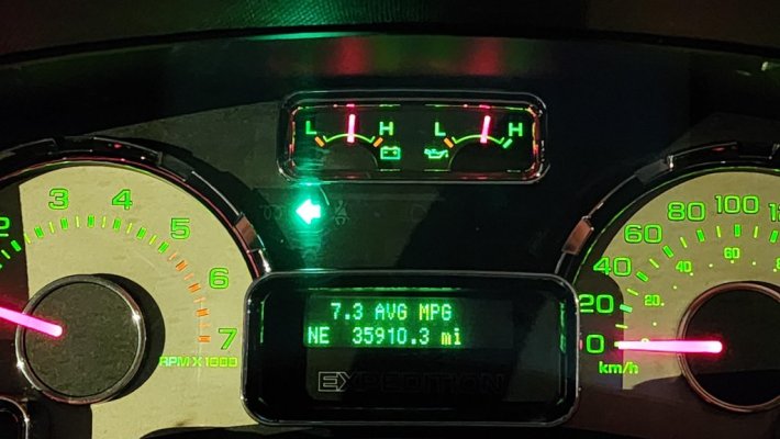

After getting the unit, I sometimes experience this Christmas tree of a console (video 1)
Video 1
that many errors probably mean a power issue, so checked the battery and negative terminal is corroded. Cleaned it, checked the wires attached. The problem cleared... But still reappeared after either a day or maybe 20.mins or 2kms after. Jiggled the negative terminal and wires attached, it Still fixed the problem temporarily. Finally, 2 days ago I tried moving further and found out that jiggling this connection removes the warning lights. (VIDEO 2) Video 2 happened again when I have to park with the right side tilted up and the warning lights immediately appeared. So I cable tied the connection so that it won't swing about... Well I was able to go a day without it appearing. It happened again today, and since I know what caused it probably, I was able to remember to take a video of the problem (video 1), what I did (video 2), and the immediate result (video 3). Resolved without me resetting the codes.
Video 3
So the question is, where is that harness leading to? Chances are to the pcm bec most of the errors is lost communication with pcm and can bus.

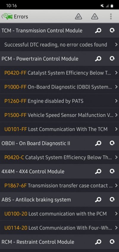

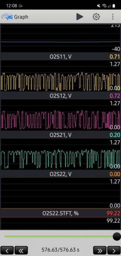

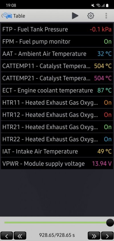

This are the codes extracted by forscan.

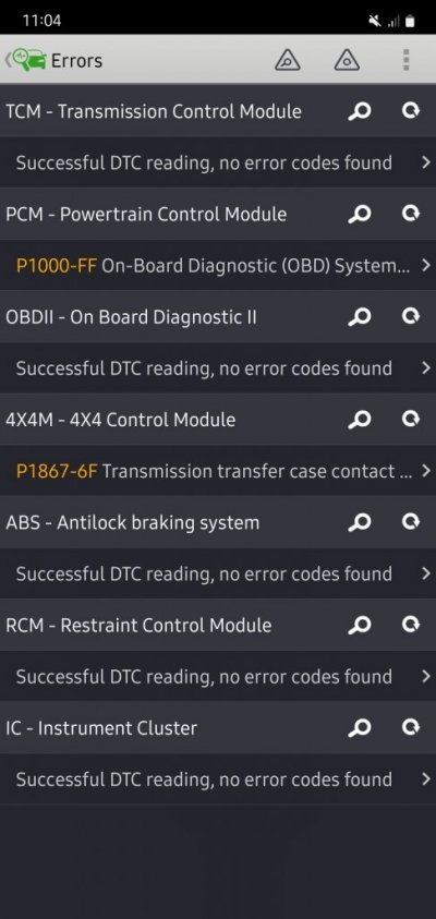

After all the warning lights went off, I cleared the codes and this were the ones left.
Live feed from PCM modules confirms the PCM is ok?
O2 bank 2 sensor 2 reads 0v. Hopefully it's just a loose connector, bec an O2 sensor costs $250 here!
