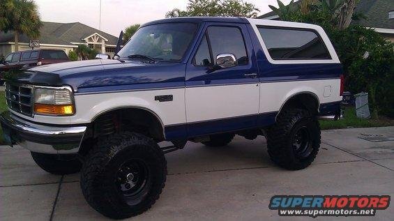

I peeled mine off but it left the middle stripe that was originally the color of the truck on. I didnt like that but once you start you cant stop. The tool i used was my fingernails lol. Just go really slow peeling it off or it will go: rip, peel, rip, peel, rip, peel, and on and on.
Took me a while but I got it doneski.
