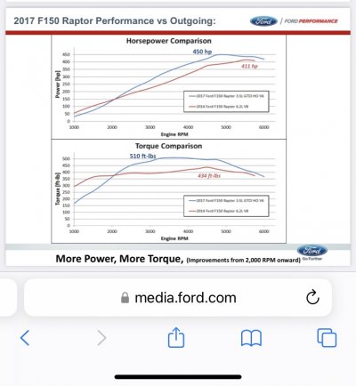

There are trade offs. HO gives up significant low end torque, the Raptor 3.5 makes significantly less low end torque than its predecessor 6.2 V8. To achieve higher top end power the turbo needs to spool later in the rev band.
There is no replacement for displacement.
Until you weigh the pros/cons relative to 85% of the buyer's utility requirements, it becomes apparent that the HO engines are marketing's fantastic ability to convince people they don't want to be "that person" with less power.
