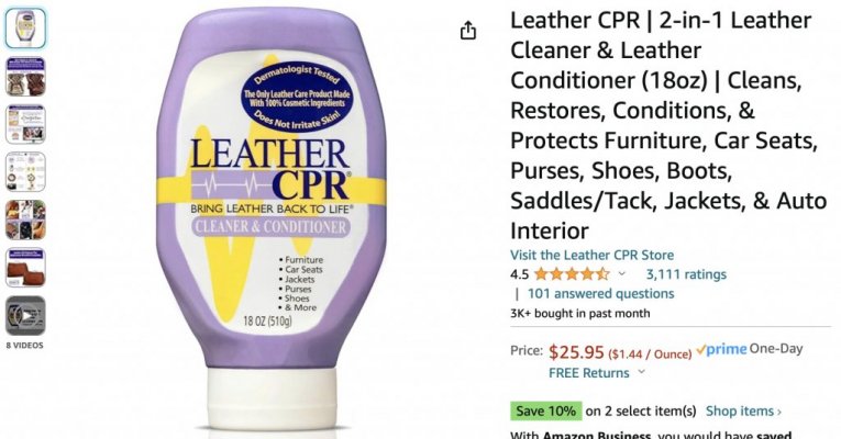

I needed to find a leather cleaner/conditioner for some leather seating in the house; the leather is very soft and had a matte finish, so I didn't want anything that would leave a shine/sheen or oily/greasy residue. Tried a few different ones, and this was by far the best, and I also use it on the Platinum leather seating, door trim, etc.
Cleans the leather and then completely disappears; can't tell it was ever there.
