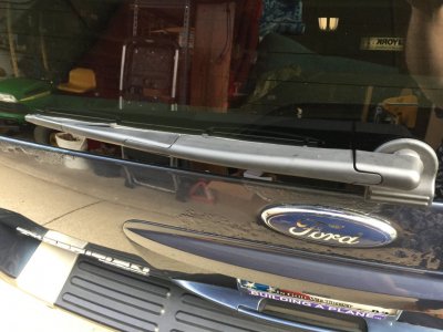

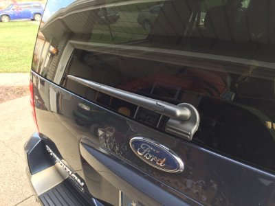

I replaced my rear wiper transmission/glass striker plate, and I changed the wiper arm and blade last Friday when it was 72 degrees outside.
It turned out pretty nice if I must say so myself.
