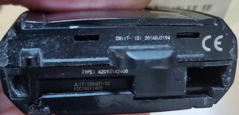

My current key is as shown in the pic below
I am not too aware and sure about various numbers on the fob. Which one is the FCC ID, or MPN or Model number.
I was not able to find the exact TYPE number while searching for a blank key fob to be programmed.

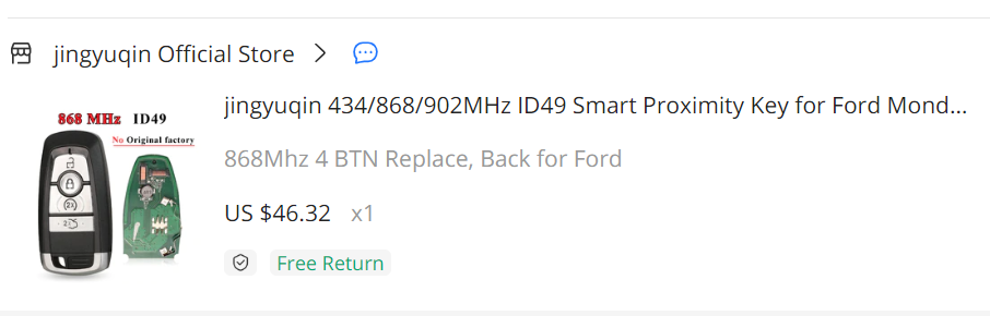

I have narrowed down the following item from AliExpress- can anyone review and please inform if I would be able to program and use it as a 2nd key.

I bought the following from AliExpress for my XLT 2022 202A.
As it was the 2nd key fob for me - hence pairing it with car was not an easy trivial task as explained in the post above. I avoided any experiments by myself as a precaution and took the key to the dealership - they examined it for a bit and kept it with the condition that they will try to pair it.
I left my car for a day for other periodic maintenance/service work, however they were able to program/sync the key with the car - and charged me separately only for this service.
You can check with your dealer if going this route would have better savings instead of buying a new pre-programmed one from the dealer (which very likely would be overpriced).
