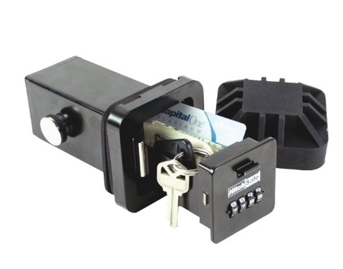

On my old expy I kept a spare key in a "hitch safe" (see picture). It's a little lock box that goes in the trailer hitch receiver. I'd like to do the same on my new 2023, but I am concerned that having the fob there would allow anyone to open the doors.
Has anyone done this?
Is the hitch safe enough of a faraday cage to prevent unlocking?
Thoughts?
(One option might be to store it apart with the battery out, but that sounds like asking for trouble. )

No keypad on door?
What about passive entry? If you do, that extra fob might allow entry in doors, and for sure in the liftgate.

One of those small faraday cage pouches should fit in the hitch safe with no problem. I have a small faraday cage pouch and with the key fob in the pouch I can stand right next to the drivers door and it won’t unlock when I press the button through the pouch or grab the handle and pull. As others have mentioned putting your spare in a faraday cage pouch inside the vehicle and using the keypad to get in would be an additional layer of security. Those wheeled combo locks are pretty easy to get into.

Thanks for the faraday bag idea!!!
My main concerns are
* Lost key
* Dead battery
The keypad on the door solves neither.
* Can't drive without a key
* Keypad won't work with dead battery
This come from years of car camping at festivals. Very easy to lose a key in a hay field. Also very easy to kill a battery while camping and recharging phones, etc.
The faraday cage solves both
* Replacement key if needed
* Can open hood for a jump start.
Thanks.

In short - NO! Use your key pad for re-entry and hide the extra key somewhere in side the truck. (Like maybe under the Jack in the back compartment.

Just pull the mechanical key out of it and put that in the hitch. That'll get you into the car even with a dead battery so you can pop the hood to jump start it. Keypad won't unlock the doors with dead battery.

I also want to be able to get in and drive in case my primary key and fob go missing.
I am now thinking put the mechanical key in the hitch vault (externally accessible) and then hide the spare fob in the truck in a faraday cage/bag.
