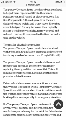

It specifically states “temporary.” You guys planning on running the full size spare all the time on your $80,000 wagons? My post is valid. Don’t wanna use caution? Thts fine. I look forward to seeing your crushed vehicle pics posted by @Flexpedition
I beg to differ. I have been a fleet manager responsible for hundreds of cars at one time. When possible we purchased full size spare tires rather than space savers. A full size spare is not a “temporary” tire. It's the real thing, rated for mileage and speed like all the other on the vehicle.
Your statement "It specifically states “temporary.” ". Is that from the Expedition owners manual or just from the tirerack.com (a place selling tires) web site?
