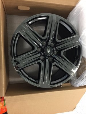

Should work, might want to bolt up a bare rim front and rear and check before mounting tires. Lot of work to break down 4 tires if your not clearing.
Agreed, I will ask the shop to mount the rim first and verify. It never hurts to test it before mounting the tires.

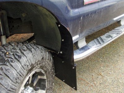

My mudflaps aren't very thick but I got no rubbing with 275/65r18 Duratrac's on 18x9 +10 offset. My rims are a 5.4" backspacing while yours will be about 6.4" backspacing. That means yours will be tucked in 1" more than mine, which means they "shouldn't" rub either but I'm not 100% sure.

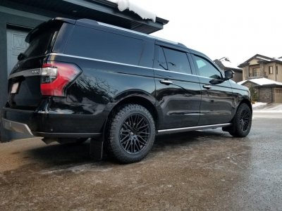

I’ve got a max platinum 4x4 with the ReadyLift 3”F/2”R level kit, 20x9 KMC XD wheels and LT285/60r-20 Duratracs. Tires are 33.5” vs stock 32.1”, both 11.2” wide. Fit perfect and could not go any larger.

No rubbing but pretty close on rear wheels inside of fender wells. ReadyLift said you can’t install their 3”F/2”R on the Expedition Platinum, You can but you need to do a little work to get them mounted and clear the electronic lines for the electric ride suspension.
