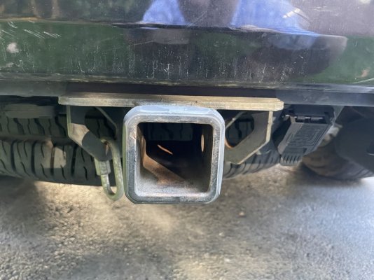

I have a 2007 ford expedition xlt, I can't tell if I have the 6000 lb tow or 9000 lb tow package and I can't find anything that that specifies the differences except the 4 and 7 pin connector, I have the 4 pin. I was told by the local ford that they don't know, no surprise there even when I gave them my vin, and because I have a spot to plug in the aftermarket trailer brake controller they think I have the 9000 lb tow. Can anybody tell me what to look for? I already tried the sticker in the driver's door like suggested and it doesn't say.

So my 2008 has a class 4 hitch, no 7 pin, no cooler. So I have standard tow. But I aftermarketed the pin and the trans cooler From all the research I found, hd tow was the same weight regardless of your diff gearing the only weight differences beyond that will be 4x4 vs 4x2. So for all rights and purposes you could add a trans cooler and wire in a 7 pin if you have a class 4 hitch to give yourself some breathing room.

Class 4 hitch receiver on a 2007 by itself does not mean you have HD Tow. The round 7-pole electrical outlet, however, only comes as part of the HD Tow package. There are other items, but the outlet is literally unique to that package. All Expeditions get the 4-pole boat trailer connector.
