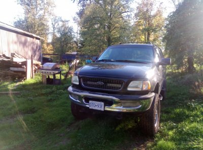

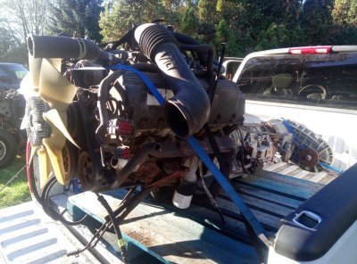

Well I've been talking the ears off people who know me for years, hell before I even bought the Expedition I've been thinking about this.

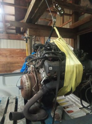

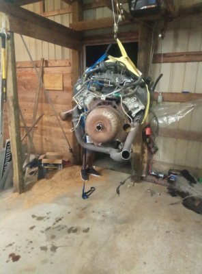

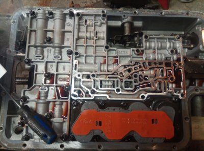

Well I landed a 290,000 km 2000 6.8L V10, 4R100 and t-case out of an Excursion. Full harness (kinda in two pieces, that'll be a few days to extend and rebuild) and PCM.
I'm still not decided if it will land in the Expedition or my 7700 F150, but all the prep work leading up to and including pulling the old engine is the same regardless and I haven't been active at FTE in near a decade so here it lands.
It's definitely bigger than you think it'll be in person..

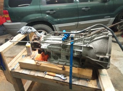

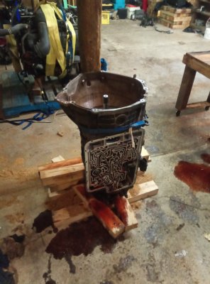

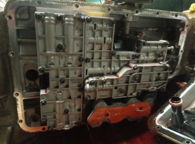

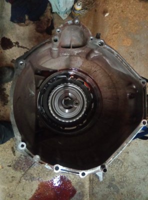

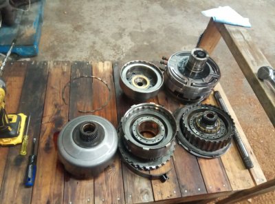

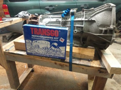

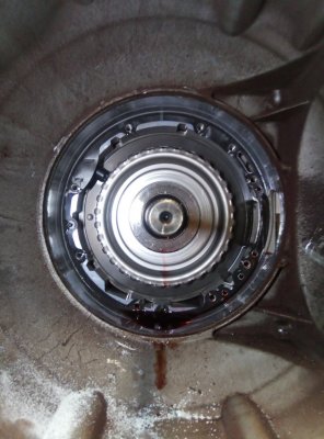

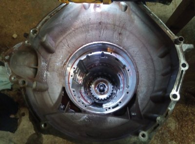

Well turned into tearing down a 4R100 with the second post .
Hard lines off.
For Professionial use only, what do they have that I don't?
Aside from years of training and experience...

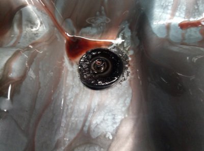

Pan off, magnet looks normal, has a chunk missing which to me makes me think it may have been rebuild in those 290k.
What we all dread to deal with.

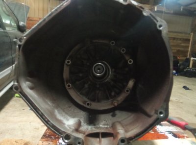

This was a **** of a workout, having the right tools helps.

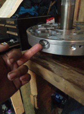

To pull the pump there are two holes that thread earlier with a thicker diameter bolt, my transmission to engine bolts fit perfectly.

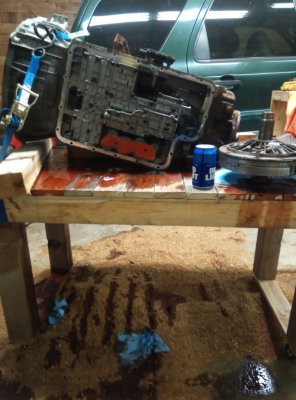

*Shudders*
Good enough for tonight, off to have a beer, a shower and watch something with the exceptionally patient wife.
Free sawdust is an amazing spill cleaner, then it burns really nicely in the fire when soaked in ATF.

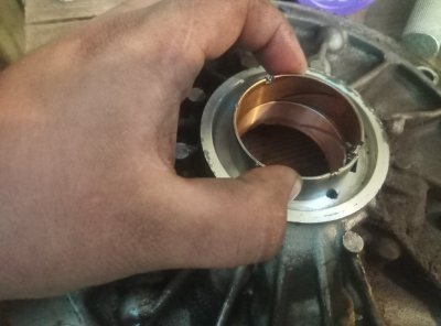

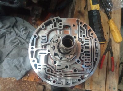

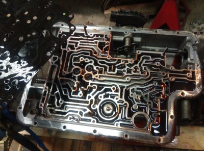

Well started stripping the pump down yesterday.
Popped the pump seal, and pushed the pump bushing out, spend a ton of time setting up the tool to install the new one. Lining up the notch, marking it to do it in the same direction and immediately put it in upside...
Called a few part stores one was straight up useless "We wouldn't carry something like that", next one "Call us tomorrow when transmission shops are open".
So I popped open the shift programmer, and then the wife came it and nagged me to go to a dog training course she signed up to. It was one of those special classes where you don't even bring the dog...
Yeah fuuuun. I'll grab some pictures of the instructions later today for anyone curious. So far it seems like a straight forward mod.
SnuffThePunkz
SnuffThePunkz
Feb 7, 2015
342
170
BC, Canada

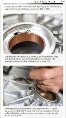

Stumbled upon this looking up the transgo lockup valve upgrade, which I'm thinking I might pick it up.
Turns out I didn't install the bushing backwards like I thought, it's just off center a touch. Not that I could fix it, and it isn't so expensive that making it work is a dumb idea. I'll just get a new one and do it right.
It was installed wrong and blocking the oil passage when serviced last. Glad I stripped it and screwed up.

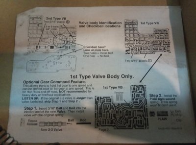

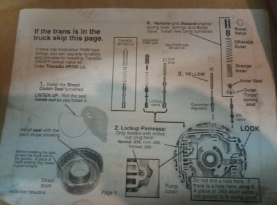

This upgrade takes out the old springs and upgrades to much stronger ones then replaces the valve with a heavier one with much tighter tolerances. Totally should be a two man job.
Instructions time.
Just finished page one.
I lied, still have to do the gasket.

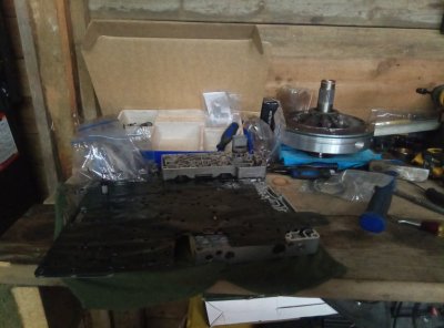

Going to pick up the pump bushing after work tonight and knock that out then maybe pull a valve body.
