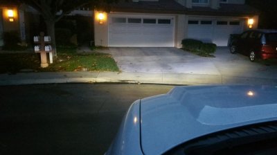

LEDs in bulbs & without projectors suck for throw (range)...they LOOK effective at first glance cuz we subconsciously associate HID white color temps with power. But they aint got reach.
specialized housings not bulbs can be a wholly different story though. Some sealed units are pretty dang impressive. My backup lights (LED pods) and fogs (sealed projector units) are pretty dang impressive, and for the fogs I know they aint even anywhere close to the best --- since I toyed with mounting a repurposed 4.5" motorcycle unit that had far better output, but gave up and returned them in favor of an F150 set that was just a couple quick cuts with a box cutter away from being a direct retrofit....
Backup pods:
Fogs w/o headlights (mounted later, not the LED bulbs in OEM-style reflectors from the pic above):
