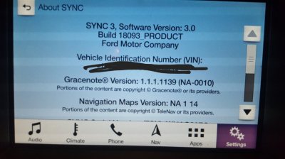

Good luck! You are on the most current version of 3.0? If you are connected to WiFi on it, and tell it to check now, what does it say?
powerboatr
powerboatr
May 16, 2016
981
378
North East Texas

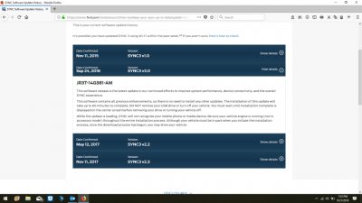

i did that and it tells me we are up to date and it even uploaded to my ford owner page and shows its the latest version.
