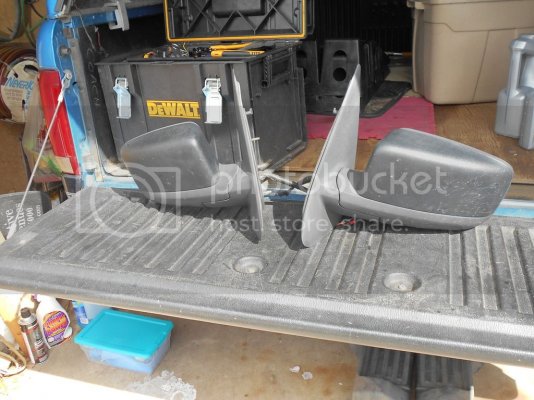

Unboxing & First Impression
When I got home a big, heavy brown box awaited me at my front door. It's hard to see, but there is a full sized hardback book on it for scale.

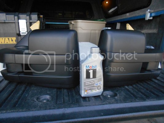

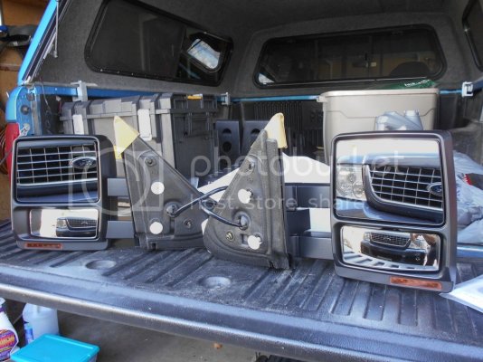

If you think the stock mirrors are fair sized, these ones make them look tiny. Seriously, these things are huge! 1 qt of Mobil 1 shown for scale.

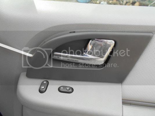

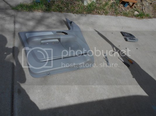

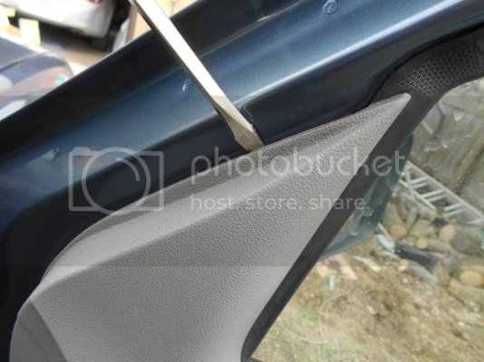

1. Remove the plastic trim around the door handle. Be careful when doing this as a screwdriver can seriously scratch up your plastic. Ford was kind enough to include a little notch in many of these trim pieces to make removing them easier.

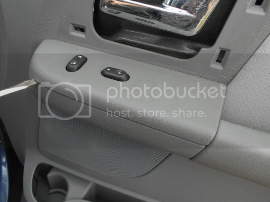

2. With the top trim piece off, remove the window control switch bezel. Using the screw driver to pry with, it just popped right off.

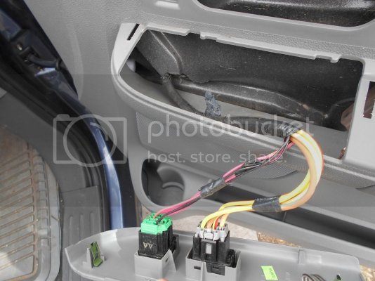

3. Disconnect any connectors on the bezel. There will be two on the passenger side, and three on the drivers side, not including the mirror control.

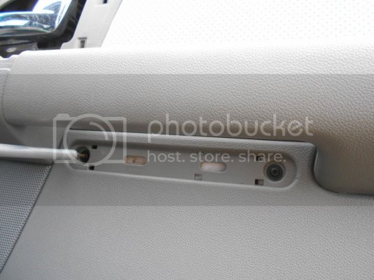

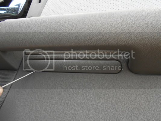

4. Remove the small trim piece directly below the armrest. I used a pick for this instead of my Flathead.
5. With the cover removed, unscrew the two Torx screws.

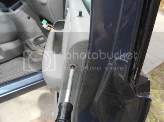

6. Remove the Phillips screw located at the top of the door panel on the side.

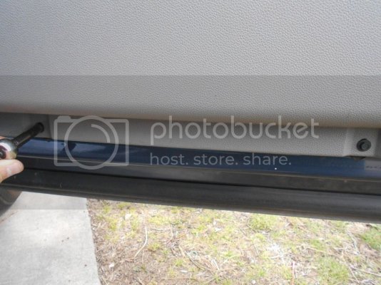

7. Using the 1/4" rachet and 7mm socket, remove two 7mm bolts on the lower lip of the door panel.
8. Using either the screw driver or a pick, pry the clip on the upper portion of the door panel out. Be careful with this step, as it can break easily.
9. Now that all the screws and bolts are removed, simply grip the door panel and lift it up and out, removing it from the door.

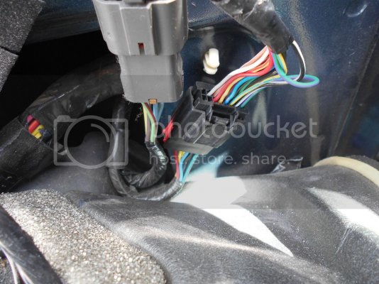

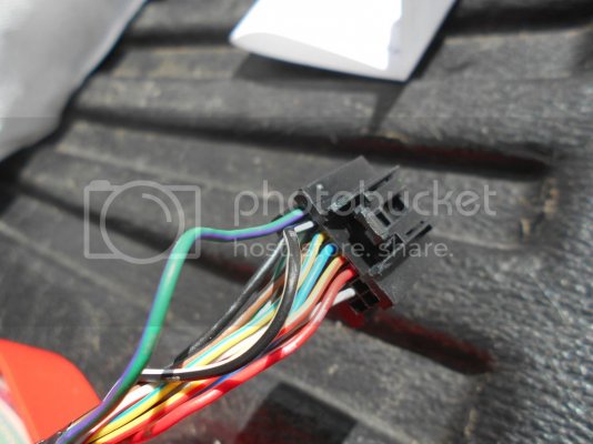

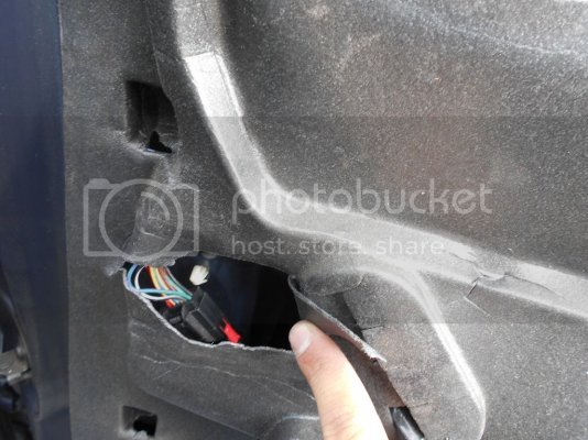

10. Disconnect the 16 pin connector from the stock mirrors to the harness in the door. Some patience may be needed with this, just keep pulling until you get it. I did not have to use any tools to get this disconnected.

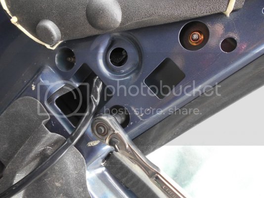

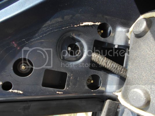

11. Remove the 3 11mm bolts holding the stock mirror in place. Keep in mind that once you loosen these up the mirror will likely fall, so it is best to have a buddy help you or simply hold the mirror with one hand.
Repeat this process for the opposite door. You'll end up with this
Now it's time to install your new tow mirrors! The installation process is largely the same, however there are a few minor differences.
To attach the mirrors, use the 10mm socket to install the three nuts that came with the kit.

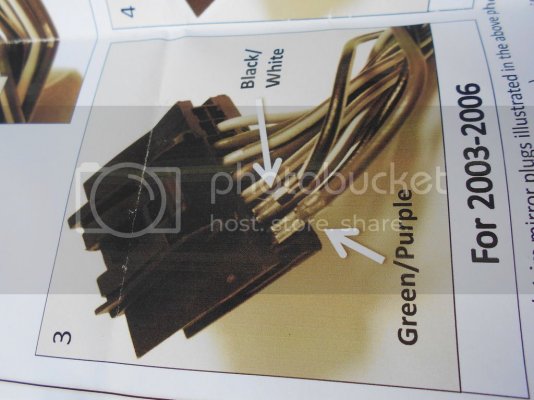

Depending on the year of your Expy, different pin placement may be needed. This is the diagram the manufacturer provided with the package.
Enlarged picture for the 2003-2006 trucks.
New mirror connector.
Now that you have the pins in place and the mirror bolted on, simply plug the 16 pin connector in with the one in your door.

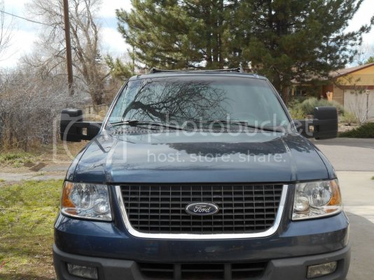

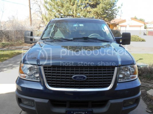

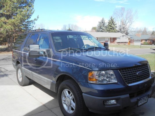

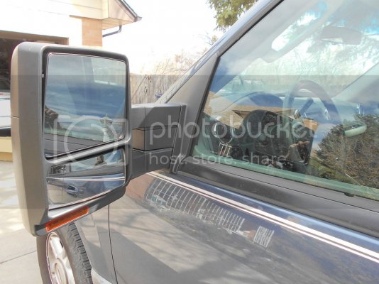

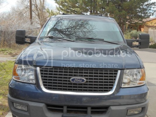

Now the moment of truth, what do they look like?:pics-****:

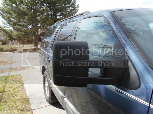

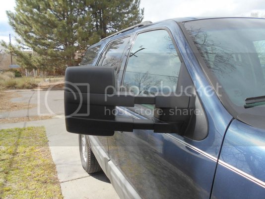

Mirrors not extended
Extended
Congratulations, you now have proper tow mirrors on your Expy!
Conclusion
Some options may not work on your truck without wiring them in (ie heated glass and signals on an XLT) because our trucks didn't come wired for them. I will have to wire up the heated glass function as well as the turn signal function to get all the features on my mirrors working properly, and I will report back my findings.The only thing I would caution you about is these mirrors seem to shake quite a bit more on the highway than the stock mirrors do, so be sure to tighten them down really good when you install them. When I go back in I will re-tighten them as I bet most of my vibration comes from them not being as tight as they could be. You could also add rubber washers or pads between the bolts and the door to try and decrease the vibration. Overall, these mirrors feel like a quality piece and have absolutely excellent visibility so I would rate them highly based on that fact alone. Now admire your truck and how good it looks with a set of real mirrors on it! The Dodge guys will now envy you even more haha. :big_banana_Dance:
