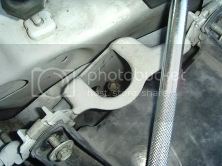

davesexplorer
Dec 17, 2002
207
Berrysburg, PA
There should be an adjuster screw in the back of the assembly, you can tighten or loosen to adjust the headlight. Stock is a gray color.

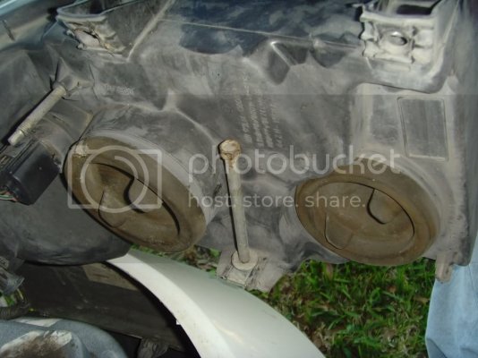

ELVATO
Nov 25, 2006
2,634
34
Orlando, FL
This is what it looks like on the stock headlights.
Headlights on:
Headlights off:
GRIP
Feb 7, 2008
120
hoboken,nj
it's the 5/16 screw just about the plug thats the adjuster the weird looking screw
