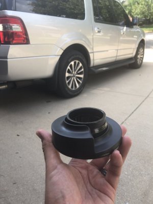

But you don’t have to destroy your old shock to get the lower spring perches.

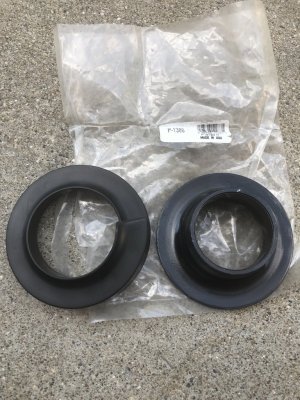

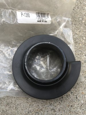

I SPECIAL SPECIAL ordered mine from NAPA. They took a little over 2 weeks to arrive which is partially what has taken me so long. As this is not something you can regularly order. The regional manager had to make a special request from the factory.
But you need NAPA part number P 1388. Mine arrived today. I paid $12 a perch though I buy a ton from them so they generally take pretty good care of me so not sure what others would pay.

Does the Napa P-1388 have a rubber / plastic isolator on it so the metal spring does not squeak when it flexes?

Yes, the isolator portion is likely a heavy nylon would be my guess.
It is not rubber but not plastic either at least I don’t think. The part on the left in picture 2.

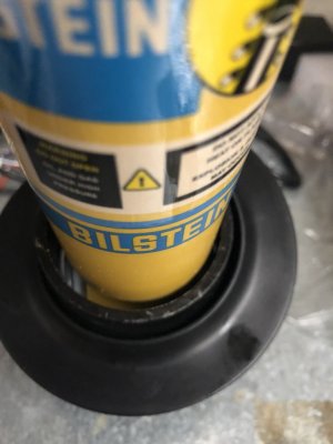

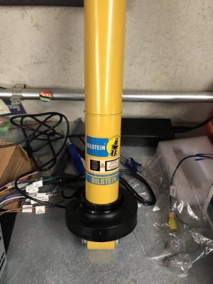

Been awhile but was finally able to order my rear Bilstein Shocks and have run into an unfortunate problem.
It would seem that NAPA uses a larger shock body than OEM and Bilstien.
Fortunately all is not lost as NascarMike has shown we can still use our factory perches it just takes a bit of extra work to get them off.
Ohh well at least the perches only cost me like $25.
