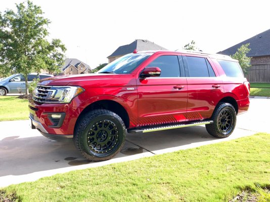

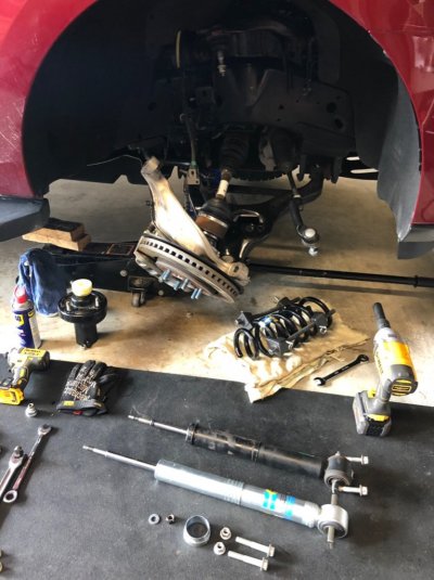

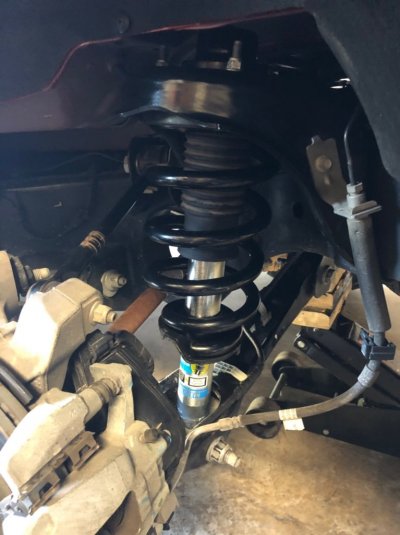

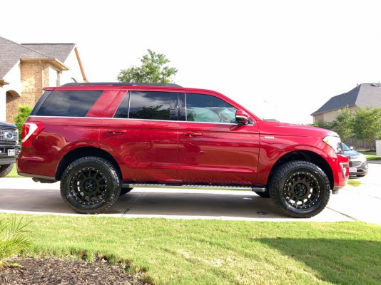

Finally wrapped up the Bilstein 5100 install this weekend.. just need to take it to get aligned now. I originally installed the Readylift 3/2 kit and then realized the front factory shocks were leaking. I ended up coming across the Bilsteins that they just came out with for the Expedition and after some research ended up buying the rears for the Expedition and the fronts for a 4wd F150. The front and rears for the Expedition state only about a 1.6” lift and I guessed that the front needed more to come close to what the Readylift kit is. After 3 adjustments on the F150 4wd shocks I ended up on the bottom ring which is stock setting and likely could have just used the 2wd shocks. I’ve only driven it a little bit as I want to get it align before letting my wife put any real miles on it but the Bilstein shocks have made a huge difference in stability and braking. Definitely happy I went this route instead of wasting time at the dealership. The height to fender ended out coming to the same measurements as the Readylift, just now it has more suspension travel. Anyways the only part that matters.. the pictures...

Thanks man. Yea I know that and ended up starting with the middle ring which was close to 1.5" taller than the Readylift. Stock setting matched great for the 4wd version. I have the 2wd shocks in the garage in case the rear came out lower than the RL kit as I didn't want any reverse rake.. but it worked out great.
The 2wd F150 shocks are about an inch shorter so close to the top setting may have worked..
F150 4wd Bilstein B8 5100 24-248129
Collapsed Length (IN) - 16.91
Extended Length (IN) - 22.46
F150 2wd Bilstein B8 5100 24-253222
Collapsed Length (IN) - 16.05
Extended Length (IN) - 21.40
Expedition Bilstein B8 5100 24-285056
Collapsed Length (IN) -16.10
Extended Length (IN) - 20.95
