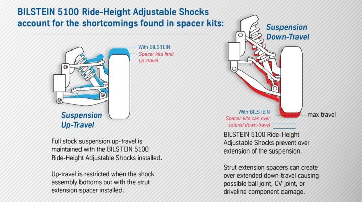

You don't want to go by his numbers being that you are a 2016. We have different spring rates than the 2018s hence the reason the 5100s for the Expedition are the same part number but give different lift possibilities for 15-17s compared to 18-19s.
