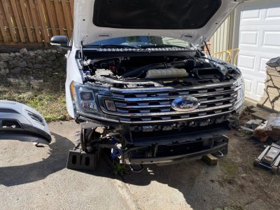

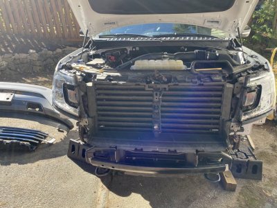

Im taking this slower than i wanted with the rain, but once i got the fender liners removed, It looks like the bumper cover shall be fairly easy. I found this pic, which almost shows all the tab/bolt locations.

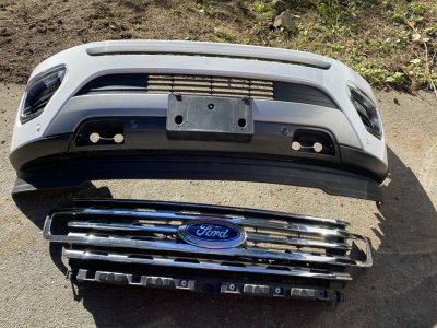

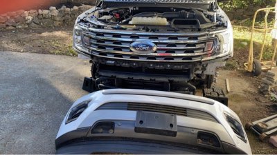

Can easily be done by yourself. Just get a tab puller and a plastic trim removal kit.
Took me 2 hours by myself to get the bumper cover and grill off.

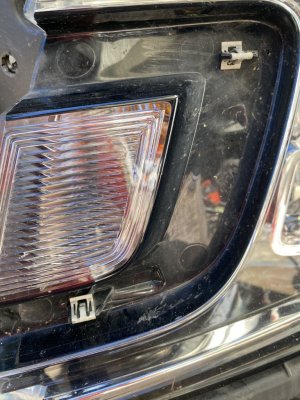

Those last two hidden tabs in the corner of the grill were tough, only because I couldn’t locate them.

Exactly, currently have the grill completely apart in 14 pieces right now, about to start the wrapping.

One think I did when removing the bumper cover is make sure there's cardboard around to lay it on - it's pretty wibbly wobbly and you don't want it to flex and accidentally scratch the paint on concrete. It's not absolutely necessary, but doing it the first time, you don't want it to unexpectedly come unclipped and fly down the driveway.
