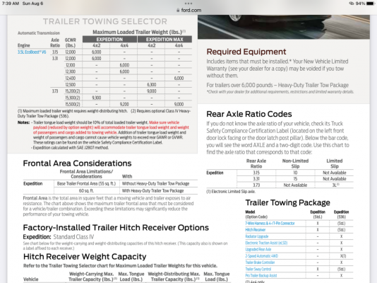

Mine is 3L as well. However if you read some more on this forum you will see that Ford uses that on both ELSD and non-ELSD from what I recall at least the newer model years. Here is the order guide showing they are separate options in 23:
Thank you for posting. For some reason I am not able to see the entire screen shot you posted, but you explained it well.

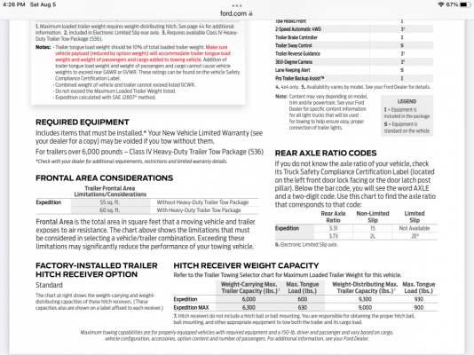

Here is a screenshot for model year 2019…

Okay, new information. I just went onto a “build” on Fords site. The package that includes the Electronic Limited Slip axle is only available on All Wheel Drive. I do not have all wheel drive. It does say that with my equipment it has 3.73 non limited slip.
To me the real issue is that it says I have the 3L axle, and as you can see in the screen shot I posted a few posts back they don’t even show 3L For 2023s, but I clearly have 3L. But EVERYTHING I have found that does reference 3L says it is 3.73 limited slip.
I am coming to grips with the fact that I probably don’t have it, which is disappointing. I can’t blame Ford because when I bought it nothing indicated that it had it. But I find the entire issue confusing and I can blame Ford for providing poor and confusing info.
