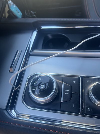

So I have a 2023 timberline with that axel code and I do have the rear locker button directly under our shifter. mine is hd tow package as u have mentioned as well (break controller and all).
Yes, ALL Timberlines have the ELSD with the simulated locker. They are designed for Off road, so that would be needed.
