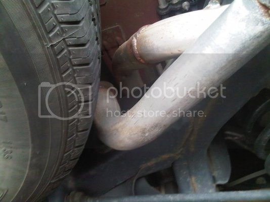

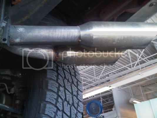

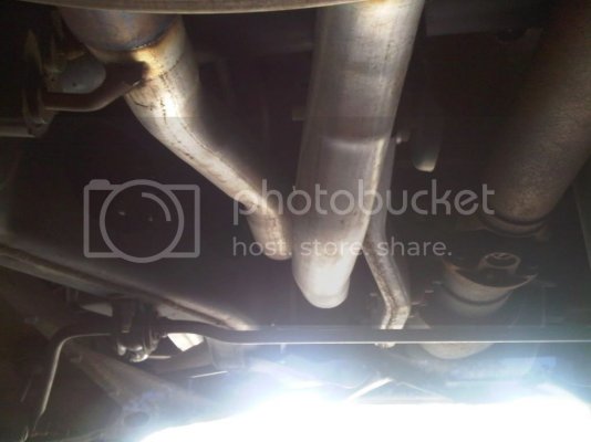

We did true duals on our 04 Expy but shop had to use 2.25" pipe after the muffler for clearance sake. It can be done but its a pain in the ass. My shop said that I would have gotten the same benefit with one 3" pipe versus duals. But I will admit, it is nice being different than most of the other Expys out there. Here are our pics:
