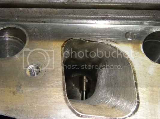

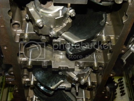

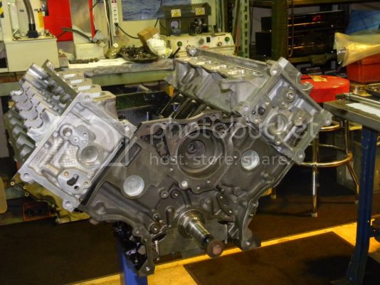

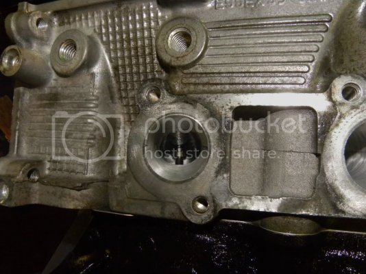

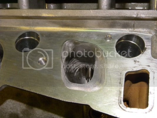

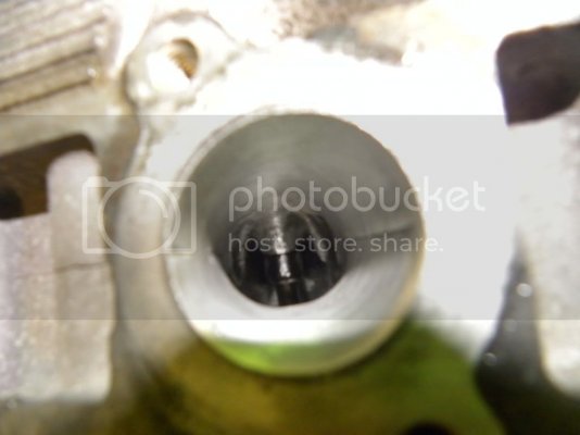

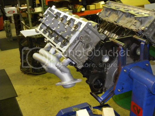

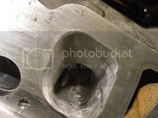

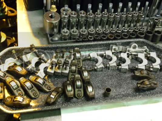

Well it has been a long time coming, but my engine is very near completion. I have some pictures for your guys, and will have more once the engine is ready to come off the stand. enjoy.
