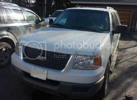

The 05-06 roof racks are interchangeable with the 03-04 models. I haven't looked into the 07+ models to see if they interchange, but it may be a possibility. Just posting this for anyone who was wondering and/or wanting to do this. I think it looks better and I did it with mine.

Yes 05-06 look way different than the 03-04. I like the look of the 05-06 better and my expedition didn't have the cross bars for it so I upgraded. Cost me $100
