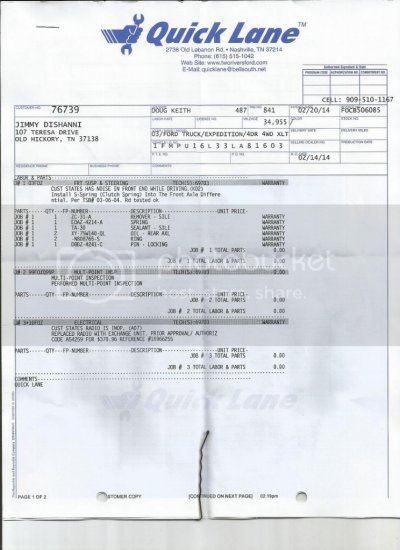

the FIX
I HAD the same problem.
I read all the forums, watched guys replace alot of parts and never fix this.
My dealership had a TSB (technical service bulletin) about the symptoms everyone is having.
I also, did my front rotors, pads and new tires...
Still there.
Dealer replaced the wheel bearings,
still there,
Transmission guy inspected a resealed the transfer case.
still there.
Then the TSB was found! ...JACK POT!!!!
Basically, the front drive shaft always turns and spins the front ring and pinion. This creates a condition where one side of the spider gears spins faster than the other side. ????? thats the noise???? YES!!!!!!!
O.K. how do you fix it? it is a spring that goes between the gears and keeps the spider gears from spinning at different speeds. NO MORE NOISE.:patriot:
Parts they used to fix it are listed below.

That tsb is older than my truck, and I do not think that the 2nd gen drivetrain works the same way.

Do you suppose that since they issued a tsb in 2004 they might have changed production afterward?

you could call a service department at a Ford dealer and ask.
I did read the actual TSB on the dealers computer, the service manager showed me.
It did mention people in 2003's complaining.
The TSB is on that receipt, so you could reference it.
Good luck
