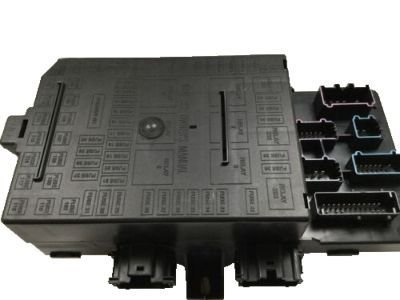

Now they say they think it's the fuse box.
Well known problem. Here is a thread on the subject. (it's a sticky in the 2nd gen section)

Do you know if they used a brand new fuse box from Ford ? ( It would have the same part number as the one they took out...). Or one out of junkyard that "looks like it'll work" ?
Because the fuse box is very specific to the year and build date of the Expedition. They may "look like it'll work" but the circuit board and programming is unique to each vehicle, right down to the month of manufacture. When things don't work after an install, that worked fine before, that suggests they just pulled one out of a junkyard, that looked like yours but was a different year, or model built. Month of manufacture, and whether or not your Expy has Heated Drivers Seat option are the deciding factors in the correct part number selection. Don't go for one out of a junkyard. The new production fuse boxes also have updated heavier duty fuel pump relay installed, so you won't have this problem anymore.
2004 Expedition Fuse Boxes from Ford
