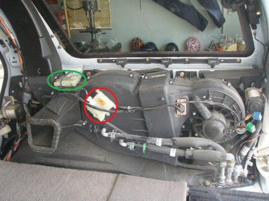

No, it's most likely a failed blend door actuator on the rear HVAC unit. Very common problem. The system freon is shared between front and rear evaporators.
https://www.amazon.com/Motorcraft-Y...H9T930NW47C&psc=1&refRID=3X3053S8GH9T930NW47C
But with the A/C on, lay under the right rear side of the Expy and put your hand on the A/C pipes to see if they're actually getting cold back to the rear A/C unit. They're just above the exhaust tail pipe, so use caution if the tail pipe is very hot.
The temperature blend door actuator is circled in red ( YH-1767 ) .... the high / low vent door is in green ( YH-1743 ) ....
