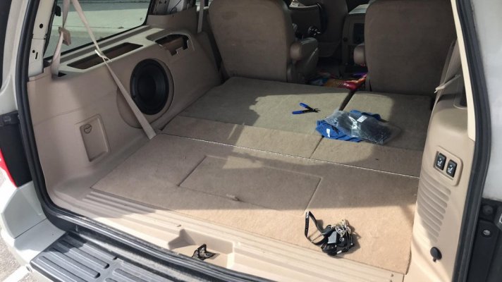

Well the truck is for sale and the stereo ripped out but here it was in its glory. Was rolling with it for about 2 years, it sounded damn good.

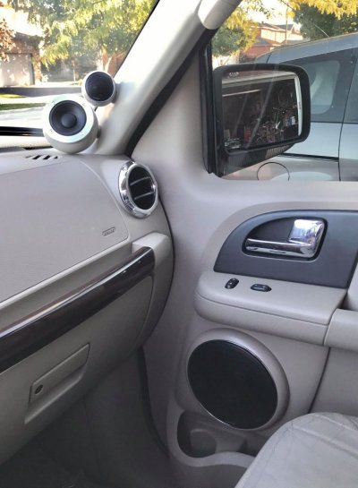

Custom pillars, door pods, sub enclosure and false floor.
Pillars were molded to fit and hide pod mounts
door pods were back braced to the door so the speakers were on a solid mount

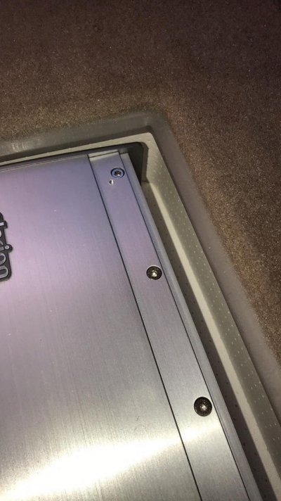

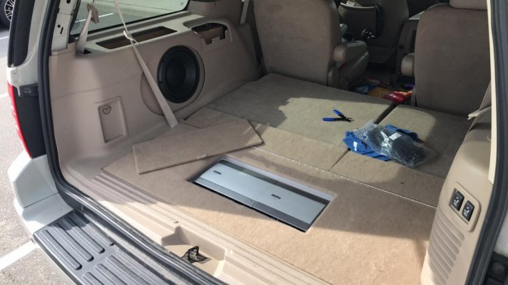

False floor had colour matched perforated leather in it to the seats and door panels, with a LED lit surround
Double DIN headunit ran optical cable to Arc Audio DSP
Headrest monitors installed in front seats
Sub enclosure was in stock location but custom made around 1.1 CB/f, fiberglass and MDF colour matched leather face and edge lit 10" sub
Speakers and subs were all Audio Frog
Head unit Clarion
Amps, one off Clarion
Should note, Floor and ceiling had 1 layer of sound deadening
all 5 doors had 3 layers (2 on the outer skin 1 on the inner)
