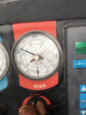

A6CC80F1-51CA-45DB-99DA-F24DC186B176.jpeg CB1CA247-37E8-4A6D-B935-19CA0E6049DF.jpeg
If you can bring the gauges to the Expy while the system and engine are cold you will be able to read the static pressure on the system. This is a rough estimate of how much refrigerant is in it. It will usually run 2-3 lbs higher than the ambient temp if the charge is real close to factory spec. You read both the low and high sides. You will also be able to see if the system has equalized since it hasn't been run. The low side gauge will have a finer scale to read the pressure.
Once you have the static pressure turn the system on max, blower on high. Make sure the cooling fans are running also. You should hear the compressor clutch engage and the gauge readings start changing. Let the system run for 10 minutes then record the low and high side pressures. If the high side pressure nears 350psi turn the system off, no need to risk lifting the safety on the compressor.
Don't ever use refrigerant that has sealer in it. That crap ruins the recycle machines. You can use the cans that have dye in it without problem though.
Cans and gauges - they run around $23 depending on where you buy it. A good set of Master Cool gauges cost me about $150 a few years ago. Which do you think is more accurate?
It was 85 when I hooked it up. We ended up recharging the whole system, but it still isn’t putting out cold air worth a crap. When it was in recovery mode, it didn’t even pull out a pound worth of refrigerant. We refilled it with 33 oz of refrigerant (because that’s what the specs I found say it takes, seems a bit low to me though), but like I said, it still doesn’t cool worth a dang. I’m simply frustrated and don’t know what to do.

Pulling out that low of refrigerant indicates a leak. Did the recovery unit perform a leak test?
Low side pressure is too high, high side pressure is about right.
How much oil did it pull out? Have you added any oil in the past or this recharge?
First item to check is the txv (expansion valve). You'll need to be connected to the gauges for this. If you haven't run the system you can get the static pressure and note the ambient temp first. If you have run the system, connect the gauges & run the system for a few minutes. Shut off and observe how fast the high and low sides equalize. Normally it should be slow. If the txv is stuck open it will equalize quickly.
