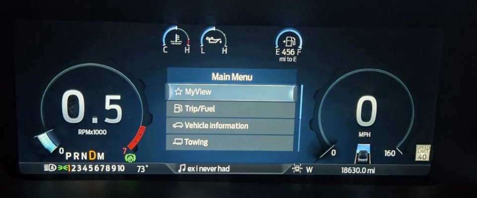

My wife's truck is doing something similar. Suddenly the trans temp gauge is missing along with the offroad page and tire pressures. Hoping it comes back tomorrow.
Edit: came back the next day. 1000004736.jpg
