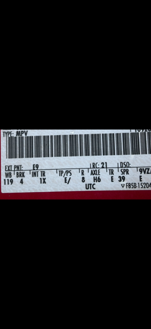

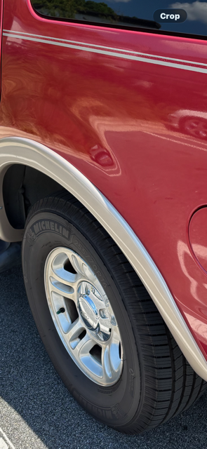

Hi,
Does anyone have any idea how I can find out what the exterior 'tan' trim color is for my 99 Eddie Bauer. I need to touch up the wheel arch trim and can't find the paint code anywhere. I've attached the vehicle label with the body E9 Laser red paint code but don't see a code for the trim color. Any help would be appreciated!

AQ - Arizona Beige

I have searched here for that information, it is there if you search. I was looking for the trim color for my Navigator and the local Napa store is making me a spray can. I gave them a piece of trim and the analyzed the color.
Ford does not list the accent colors. I was looking for a gray for the Lincoln, my 04 Expedition EB is more gold.

I had a can made for my hitch cover, the color is good but the finish is new. I will just repaint the bottom half of the rear bumper and continue forward if needed.
