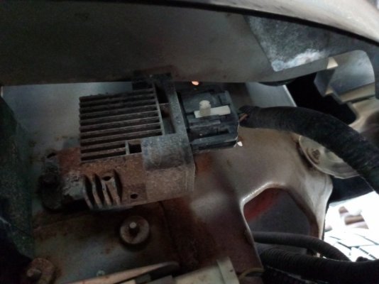

Here is the DRL module on my 1997 Expedition. It is visible through the hole in the bumper on the driver's side.
If all of the fuses etc. are good then it should be this unit that needs replacing (wreckers).
