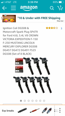

My wife had same issue on her van. Cleaned idle air/egr new plugs even though ones on there were fairly new, new plug wires ours would be coil boots, cleaned MAF. Cleared up the problem. You can check coils http://easyautodiagnostics.com/misc-index/two-wire-cop-coil-tests-1 also the “ high spark “ accel/Msd are a waist.

DG508 Motorcraft $40 Rock auto
Try a pick a part pull off a 4.6/5.4/6.8 get way cheaper
Amazon has a pkg deal 80 for 8
Off brand
Accel and msd not worth the price.
