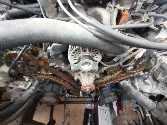

I'll have to report back on the new ride qualities later. The day after the shocks arrived I started hearing strange noises from my engine compartment. It's the dreaded sound of a chain dragging on a guide. New timing set, gaskets, & oil pump are on the way......
