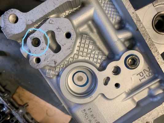

If its not the valve cover gasket. There is a small oil passage plug that screws into the back side of the heads, where the chain tensioners would be on the front end. The heads are interchangeable and drilled and machined on both ends for chain tensioner mounting. That tiny allen screw plug blocks off the oil passage that would feed the chain tensioner if it was mounted there. If it's loose, oil under pressure can seep past it. My money is still on the valve cover gasket or grommet on the valve cover bolts though. Sounds like you're getting more than an occasional drip though. Can you get a bright flashlight and see anything up there from underneath ?

I’m familiar with the harness bracket (see pic). The original engine has 260k on the clock. Last thing I would want to do is pull the engine for the head jobs, just to have the engine crap out shortly thereafter. BC325476-EC0A-4944-97B7-D597AD1AD4BB.JPG
