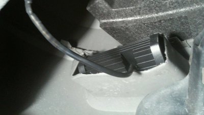

No, There aren't any direct aftermarket whole assembly replacements for the fog/driving lights. That is why I went ahead and retrofitted the LED assemblies that I have on my Expo now.
It was a lot easier than I thought it would be. I removed the entire stock assembly, clipped the tabs from both long sides and one short end from the back, press fit the LED from the front, found my angles and used a 45-degree drill to make my holes for the bolts that went into the sides of the LEDs that would've held the supplied brackets in place.
I did go to FastenAll and got replacements stainless hardware because I didn't trust the Asian hardware that was supplied. Also, I used some blue LocTite to ensure they wouldn't back out from the vibration.

Thanks Certus, looks like a path I can take.
Quick questions: how bright are these puppies? Would it be safe to run them using the OEM harness (using a relay if they draw more then stock) IE all I need to do is pull out the light switch like I do to turn on the stock fog lights and also having them on with low beams then automatically going off when high beams selected? Or are they to bright to run on the highway with low beams?

I used the OEM leads but added a relay to ensure full voltage being sent when on. By default, they will turn off when the high beams are selected.
They are BRIGHT but other people's safety is not my concern in the end. My concern is for the safety of me and mine.
You could, if you were so inclined to do so, run a completely independent switch and harness so you could run them independently at your discretion.
