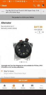

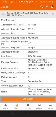

Has anyone ever upgraded thier 2nd gen Expy Alt to a high amp 2015 Ford Superduty 225 amp alternator? Has the same exact 3 prong plug and same mounting. Just not sure if I'll overload the electrical system or burn the ecm. Thanks.

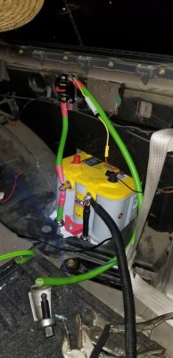

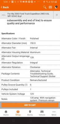

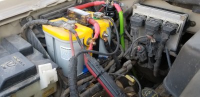

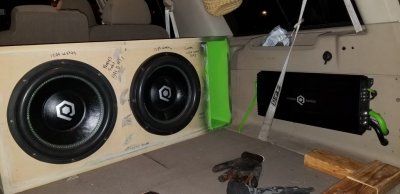

So what would you suggest stamp11127? My issue is my 2300 watt 1ohm monoblock amp. The amp drops the voltage down to 11 volts according to my 60 sample per second digital voltmeter. I'm running 2 yellow top Optima, 0 gauge lead power cable, and a 135 amp alt.

At idle my amp shuts down when the voltage drops down to 8 volts. I understand that the rpm is around 600 rpm and the pulley is stock, not smaller. But when I'm driving say 2,000 rpm, depending on what song I'm playing with bass frequencies around 80-120, the higher frets pull a lot of current which will shutdown my amp. That's at 2000 rpm cruising speed. But ill look into the post you mentioned Thanks man.

You've got one serious amplifier there at 2300 watts. That's the highest I've heard of for an Auto. You need to run a dual battery setup like Toby stated. Interstate has some humongous deep cycle batteries available. I saw one that was like 3 feet long. It gets mounted in the rear with long heavy duty cables. As Stamp stated your alternator is only going to charge just so much, the voltage regulator will see to that. I'm surprised you or the shop that installed this Godzilla of an amp, didn't install the total package. You wouldn't drop in a 600 horsepower engine into a car/truck, without brakes to stop it! Look into the dual battery setup with the isolater. And of course the bigger alternator.

I installed 2 yellow top Optimas, 0 gauge amp kit, new 135 Duralast Alt, a 250 amp battery power isolator.
