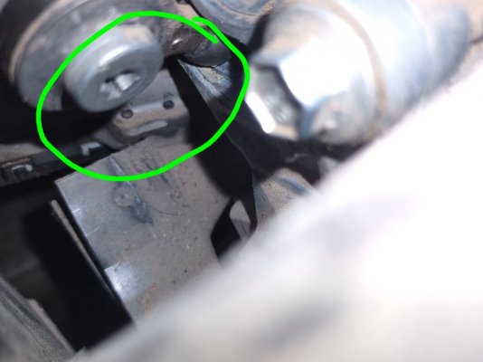

This part in picture broke. The rounded top broke off smooth from the smaller lower part. How do I get this out without breaking or stripping anything to replace the part? See pic below. Thanks for any help.

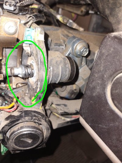

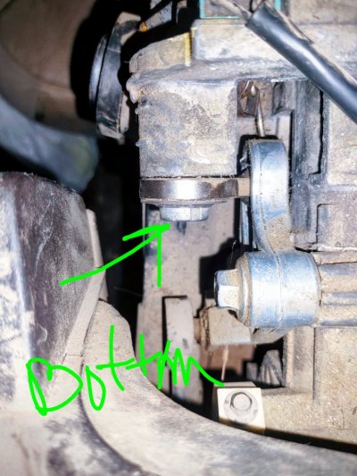

Trying to post more pics so everyone has a clearer view of where it's located, where it broke and what all it is attached too.

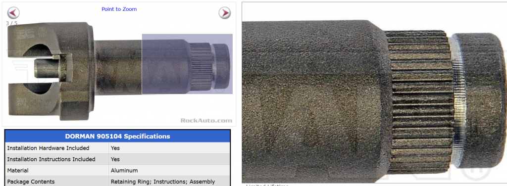

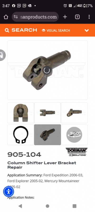

These are available but used is all I can find. I'd much rather just buy the one part instead of 5 or 6 pieces. But unable to find how to take it out without messing something else up. Any ideas at all?
