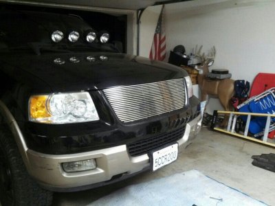

I'm going to Starr this as my build thread.

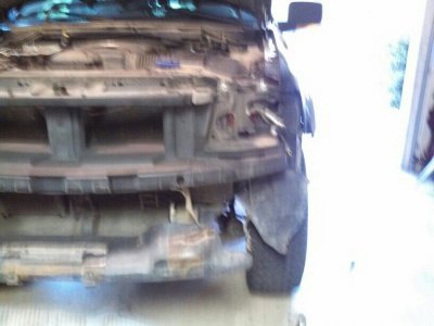

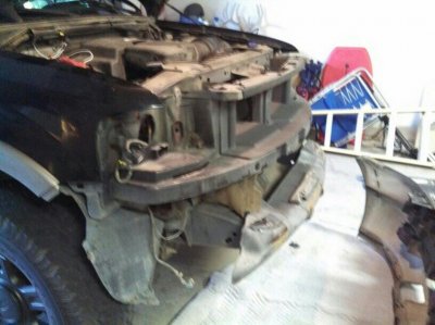

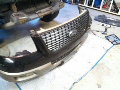

Bought a Still bullet grill new off Craig's for $40. Went through the install and quite the pain. Directions sucked. Eventually I figured out you have to use the original trim and bolt in the brackets to the frame of the car.
Next I'm going to dip all the tan trim and dip the chrome background of the headlights

How long/hard was it to remove and then reinstall the bumper cover? Are there many screws?
I manage to crack mine last winter and plan on changing it at some point.
R
rock3ralex
Feb 26, 2013
71
Pomona, CA
Nice!!
very easy. There are two screws under the hood near the grill. Two under either fender and two near each fender well. Takes about 10 minutes to remove. Just look up a guide on how to install a grill and it'll tell you how to remove it. :signs1:

the problem is if u try to install the bottom grille...there nothing to attach it to down there so u have to weld it to the frame
I noticed that as well that the lower is part of the bumper cover. Don't the lowers come with mounting brackets that you have to drill though?
no not to drill through...the only way is to have it welded to frame when pumper is off...any other option im not aware off...
