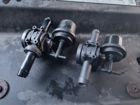

- heater valve ( works on underpressure ) not working. It's nom metter angine cold or engine hot. No metter I set vents temp to low or to high. Valve is still open, old and new one. I have underpressure on inlet line but on line to valve zero underpressure.
