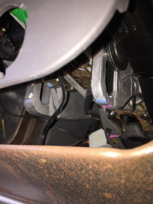

Thanks for your responses.
I have no idea where this release button is under there. However, sounds like I need to replace the brake switch.
Hopefully, that will solve the issue.

I cannot really see what I am supposed to be pulling / pushing for the override. I have had my body under the dash and just don't see / feel this "button."
So I have not been able to move the lever and the brake switch did not help.

They used the same actuator from 2003-2007. So it's gotta be up there somewhere. It's just a little button on the back end of the actuator, just like in the video above. You can easily reach it and depress it with one finger through that hole there. It pushes in about a quarter inch and releases the shifter. I just went out and tried it on my Expy and it was pretty easy. With your palm up you have no problem feeling it there through that hole.

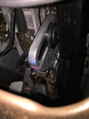

So the Expedition now comes out of park with the new Neutral Safety Switch.
Thanks for all the help and suggestions everyone.
Got this installed last night, but work was a pain today and just taking a bit of a break now.
Once I was able to align the key ways to the shaft I was able to pilot the switch onto the shaft.
I used a sharpie to make some marks on the shaft and the switch on the and that worked really well.
I still was not able to push it on all the way by hand. However, I got it far enough where I was able to use the fasteners to draw it onto the shaft. I then loosened the fasteners to set the adjustment. I think I did that part correctly. Seems like everything lines up with the indicator and no issues selecting any gear.
