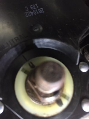

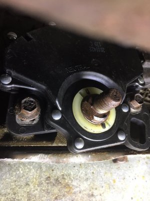

I did take some photos of the position of the safety switch alignment marks. Not the best being under the car and trying to get a good angle to see the marks straight on.
Will load them up latter today.

Well, I have been doing more driving and so far so good.
Here are the 2 photos of the safety switch, aka position sensor :)
SO I added the black marks onto the plastic to help me align the slot in the shaft for installation. You can also see I put a mark on the shaft as well to assist.
Once I did that it was pretty easy to install using the bolt to pull it onto the shaft.
The more close up pic shows the alignment with the marks.
I think they are right on. A bit hard to see and make sure when you are under the car and looking on an angle.
