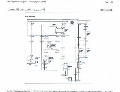

I would check the wiring from the battery to the starter and everything in-between for any signs of corrosion and also for tightness.
Can you read and understand wiring diagrams?
when you have a no start condition Dose the starter kick over or nothing?

Can you check fuse #101 in the fuse box behind the kick panel The fuse should have 12 Volts at all times Use a volt meter or test lamp don't pull it and just look at it.
Get the input and output voltage
You say you hear the relay clicking.
Have you replaced the starter relay in the fuse block?
Read this if your unsure as to how to test a fuse
http://www.expeditionforum.com/200023-post1.html
