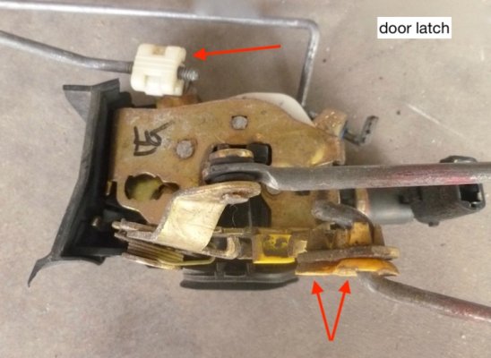

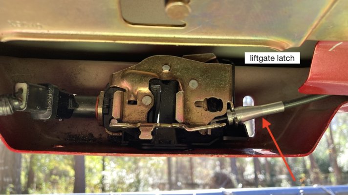

@tactful_1
Those are very common Gen1 lock issues that usually owe to deteriorated plastic - bushings, clips, end-pieces, etc. The good news is that you can fix them yourself for $20 or so.
I'll be glad to go into more detail if this gets a response.

Thanks for the reply. I may have some pieces that are either broken off or missing now, but if I can help getting this resolved, that would be awesome! This is the main driver door that I want to fix. I’ll pull the door panel off tomorrow and snap a few pics then maybe you can help me from there.

The loose actuator sounds like it is working but it is just slamming around unsecured.
Yeah, if the actuator is bad, that's a completely different jar of flies and good luck fixing it yourself. But first see if any of the door latch linkages have failed. Pull off the trim panel and peel the dust shield back past the inside door handle. Then check that all five latch rods are present and secured at both ends, nothing loose or rattling. How to proceed depends on what you find there.
