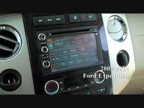

Any how-to's on pulling the radio? Seems I also need to repair or replace the lighter socket that's on the same silver plastic panel. May as well do a two-fer fix.
Any kits out there for installing an aftermarket stereo that works with the subwoofer in the back?
JimR_TN
Oct 30, 2022
96
64
Middle TN
I just went through that in my 2007.
Good video specifically on the Expedition:
Good video on installing aftermarket stereos:
I used the Metra 95-5812 kit with Metra 70-5520 wiring harness and Metra 40-CR10 antenna adapter. It really wasn't that bad except that there is no switched power in the harness. Took me a while to figure that out. You will have to wire that to switched power somewhere else or there may be a kit that handles that. The Metra XSVI-5520 *might* take care of that power issue, however I discovered it after I did the install.
I also installed a backup cam with the stereo upgrade which wasn't too bad.

Once you see that video, you'll realize how easy it is to pull the radio. Just get yourself a set of those plastic trim tools.
My 2008 had the basic stock radio/CD player when I bought it (used). Ended up finding the upgraded version with GPS on EBay for ~$125. Only had to add the GPS antenna (from Amazon) and I was good to go.
Still not a great audio system, but a bit more modern looking and has the GPS functionality.
