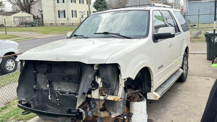

I picked up a 2007 expedition and boy I tell you all the bolt on this are gone I’ve had to cut all of them off just to change struts ended up having to get upper control arms tie rods ball joint and now I see the rear axle is t even seated into the differential any help or info doing these would be helpful thanks

I’ve already committed so far to give up on it I got basically everything off on the front but 2 top nuts for the strut then I can reinstall all the new parts on the drive side I then have the pass side to do then I’ll tackle the rear just not much room to grind off the nut on the strut could ride pretty well when done I hope I started all this cause 4x4 wasn’t working and guests a noise in the hub found out I have no vacuum line to the hubs the activators was shoot on the hubs

It’s actually not too bad interior is clean just underneath has rust and shit . body was not bad I have bumpers off to replace with new ones someone hit a deer so I resprayed the front bumpers and need to replace my power steering lines as well with all the suspension components also trying to fix 4x4 I do t think it works so I got new actuators things at the hub the solenoid and going from there

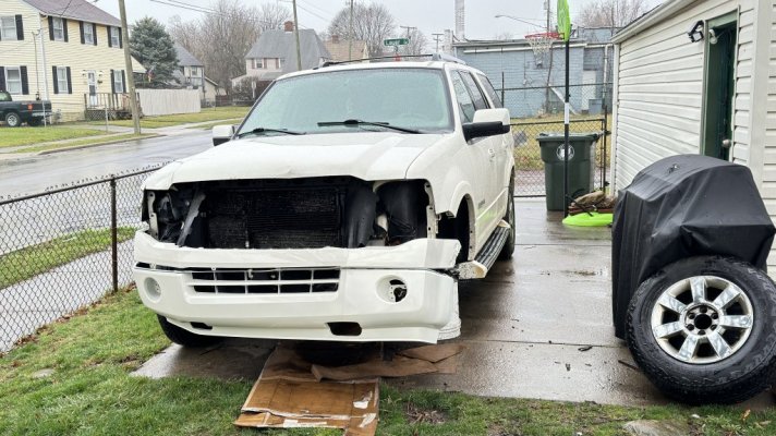

front bumper came out nice first time painting anything just IMG_0872.jpegdid the two front bumpers a little thin on the sides but will do sorry it’s not bolted up yet just mocked it up to see after the clear coat dryer also finally got the old strut out and started to reassemble the front driver side next on the passenger side then the rear

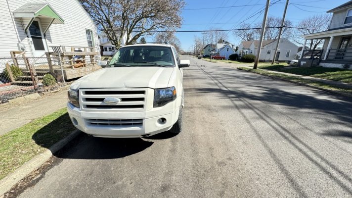

Well drive it to work today. Had to fix the power steering leak ended up being the hose that connects under the power steering pump. Haven’t done the passenger side yet waiting for warmer weather here this week but it’s making almost a pump/tranny humming noise not sure if it’s the rear end or what but I’m pretty sure it’s leaking back there because of the differential gasket or the rear pass seal has a lot of moisture on it and leakage. Kinda worried my ps pump is on way out maybe not too sure how hard it is to change out but it’s a work in progress. Still need to pick up a good hood if anyone around Ohio has one for sale maybe.

Ok the power steering pump noise went away so maybe I had bubbles in the system. Started on the passenger side for the hub stuff and joints and strut and is goi g way better then the driver side so far should have the front all done by tomarrow on my day off. Now I need to source the vacuum hoses for the 4x4 . Are they something I can get through Amazon or do I need dealer for that I’m pretty sure they are shot. If I apply vacuum it just leaks out quick . Thanks
