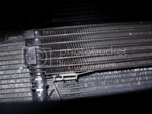

I looked at my sticker and it says I have the $395 "Heavy Duty Trailer Tow" option. Here is a pic of my radiator I just took. Dont know if this helps or not.

That's it. Seven (7) rows. (Only looked like six in the first photo.)
Nearly full width. I stated full width earlier, but this is as wide as they get.
