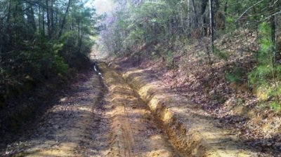

I just inherited my wife's 2008 Expedition EL (she just bought a "new" 2014 Expedition EL & handed down her old one). I want to use my 2008 to do some off-road driving (dirt roads/ruts for camping/hunting trips), and eventually to tow a trailer & haul a side-by-side.
Outside of putting on some dual-purpose tires, what modifications would you recommend for this? lift kit? bigger wheels? change gearing? Anything else? Are there any products you've used that you'd recommend?

Ranchos or Bilstein+Liftkit spacers
LT Muck tires
Ditch running boards if you have em
Add skid plates if you don't have em
Some kinda brush guard
Add lights, the $14 Amazon Chinese LED bars are surprisingly kickass so no real reason to break open the piggybank for $200 ridgids

PS the road above can likely be handled all day long just by adding LT BFGs or similar (hear people loooove the much cheaper Nittos)
