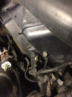

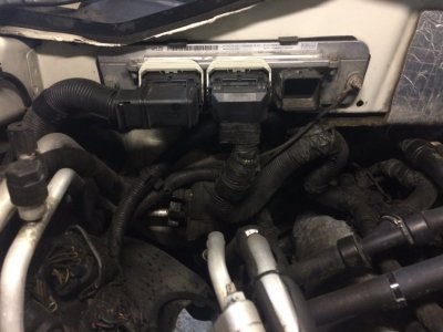

Hey all. Well I know this is an old thread but I still got this issue. I haven’t done anything in a year because I was deployed for OIR in Jordan and Syria. I left on Jan 2nd 2018 and just go back in the good old USA. With winter already here in PA, I started, again, to looking into this problem.
I found the IWE solenoid but it does look like anything I have seen on this or any other board. Mine isn’t attached to the firewall but is attached to the radiator shield and it looks like it has a vacuum container attached to it. Photos included. Has anybody seen this before?
And has anybody found a solution to this issue? No AWD or 4H but I can get into 4L. I can hear the solenoid in the passenger kick well click on when switching into 4L. But not AWD or 4H. Any advice on where to go from here?

Hi there jj86gn, I ended up getting the problem resolved. The dealer level mechanics ended up being no help to me long story short. When I brought it back in to service they replaced the passenger side hub actuator instead after I told them bypassing the solonoid didnt work. Turns out the solonoid cant be bypassed anyway! If it’s shorted out or the computer can’t communicate to it the vehicle will not shift into 4x4. Yes that little part that says made in USA on the cap is the solonoid. That’s where they mount on the Expedition. I ended up replacing that which solved the problem with lack of dash lights and engagement. More recently I also replaced both hub actuators and the check valve for maintenance items as I was getting some grinding. System operates properly now.
